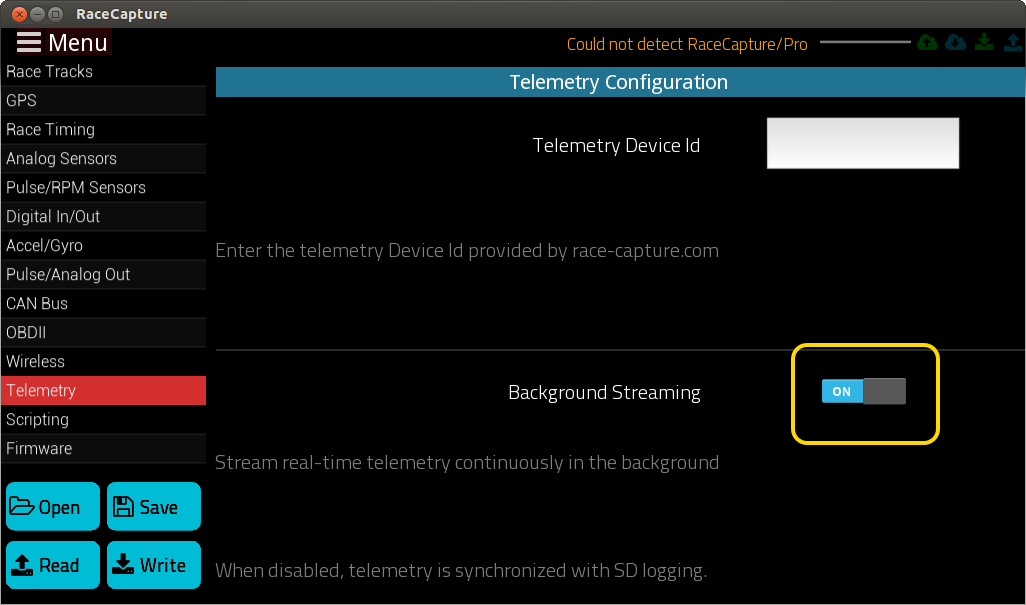

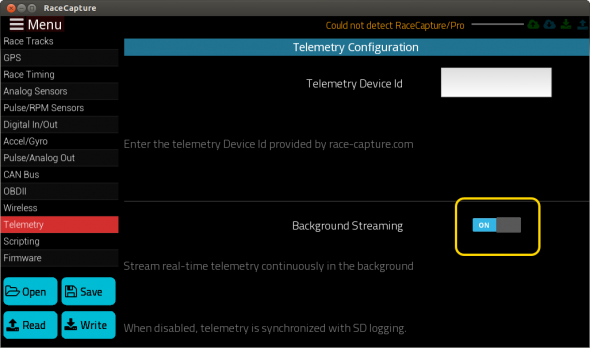

Background streaming
You can now better control how telemetry streams in the background. Disabling background streaming means telemetry is synchronized with SD card logging. This fix prevents the Bluetooth link from being affected.
